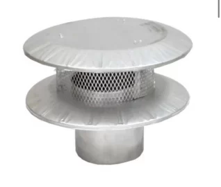

I’m having the hardest trouble finding a chimney cap for our Martin SC36(B) it’s the SC round chimney cap with storm collar.

That could be a tough one. I'm not sure that they are made anymore. This may be the same as the
8203D Tempo chimney cap if that helps at all.
If no success, something may need to be substituted that fits into the inner liner, yet lets the outer air jacket breathe freely while shielding it from the rain.
