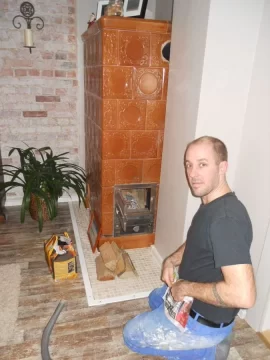

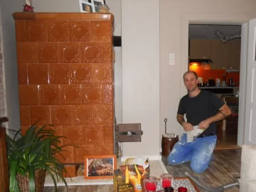

i'm an american ex-pat living in germany with my (german) wife. we're remodeling our home and we were fortunate enough to have a "berliner" ofen (stove) in our living room. from my understanding, a "kachelofen" is not a true masonry heater. a kachelofen heats through radiant heat as well as circulated warm air. it contains an air vent at the top of the stove that circulates warm air. a "berliner ofen" is the true masonry heater that heats only via radiant heat.
as far as my experience goes with it, it is a beast of a heater. upon arriving, i knew next to nothing about them. i told my wife, "we can get rid of it, and put a nice fireplace there!" what an idiot i was. after some locals telling me how stupid that would be, i began to read more and more about it. i'm glad i listened. whereas fireplaces are around 10percent efficient, i've read (probably optimistic claims) that masonry heaters are upwards of 90 percent efficient. i burn a small load of wood once a day (twice when the mercury really drops) and it heats for 12-18 hours. i can burn moist, crap wood (albeit more of it!!) and produce heat for 12 hours. i don't have to worry about creosote as it burns full throttle until the wood is about burned through. when i have good embers, i close the doors and seal it up. not worried about CO at that point. we also burn brown/lignite coal briquettes in the stove with wood to help hold the "glüt."
either way, if one can do it. do it. it's like having a little sun in the room. after working outdoors in the winter or taking a shower, my wife and i like to stand against our "berliner." even though it has an extremely large amount of heat stored inside, the outside is never to hot to touch. it is amazing. even mark twain was flabergasted by the kachel- and berliner ofens.

Welcome Photoboy, pull a chair to our glowing hearth and join the crowd.
There is a ton of information on these kinds of stoves. A search for -thermal mass heating - will fill you with all kinds of ideas. Some community colleges offer courses in their construction. At one point I wanted one of the German stoves, until I found out they were not imported. Anyone know why, or has that changed?
Hi photoboy and welcome. My friend's kachelofen is a true radiant heater with no air vents. Ernst Keisling,the builder, is from Austria so mayby there are regional differences.The Finns and Russians all have names for these heaters.These heaters are all custom built to a design for a specific location so the components are available you just have to know how to put them together. Whatever you call them they are great heaters and very efficient.
That's a great looking stove...for kicks how much would this cost (approximately) new where you live in Germany (assuming one's house already has an adequate foundation, admittedly the biggest factor for me, which is to say I have no foundation for an 8,000 lb. beastie). There are a lot of numbers thrown around on how expensive they are here. Your foundation underneath (assuming you have a basement) is likely all block with perhaps a concrete pad?

That’s a great looking stove…for kicks how much would this cost (approximately) new where you live in Germany
thank you! we are very fortunate to have it. i remember asking how much that cost to the previous homeowners and they said 900 East German DM. The cost was artificially lower because the gov't helped pay for it but the homeowner wasn't able to choose what ceramic tiles were used. could have been real ugly. brand new i've heard from 5,000 to 9,000 Euros with foundation. cheaper if one does the work themselves.
the cellar of the house lies under the kitchen only so the berliner is on a cement pad which rests on gravel than earth. originally, the foundation was just painted an ugly maroon and covered with a metal plate that rusted. when we remodeled this room, we laid mosaic tile to make the area nicer. i just wish i had chosen a darker tile, graut, and caulk!!! even with a sealant, it's starting to get dirty from ash!!!
