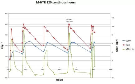

On the side of my masonry heater, I gave 2 temperature gauges. One reads the core brick temp, the other reads the flue gas temperature, right before exit.
I logged the data for the last few days.
Hopefully the image comes out.
The down slope of the core temperature represents about 10,000 lbs of mass cooling off and dumping 6- 10 thousand btu's per hour into the house. Some of those down sloping lines last 24 hours.
The green line is mbh/hr in based on the delts T of the core.
Thanks Bill, the image came out, and it's neat data. Could you explain what mbh/hr stands for, and its significance?
btu's per hour, or thousand btu's per hour is the heat output.
Usually heating devices are rated in this unit.
For instance a boiler might be rated @ 100 MBH ( thousand btu's per hour)
baseboard heat is rated at 600 btu/hr per foot.
In this case, the loss of core temperature from the core mass is the ammount of heat that the room gains.
That is shown on the down sloping core temperature line. The up sloping line is the heat gained by the core during the burn. The values arent real accurate because lots of heat is going into the room, through the glass door at the same time. So the heat into the room during the burn is understated.
