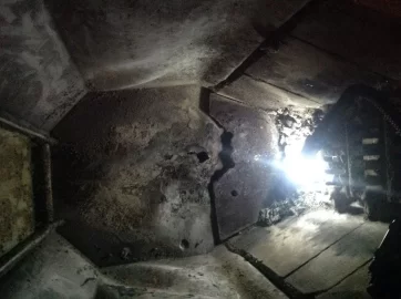

Shouldn't there be fire bricks at the bottom? I assume we're looking at the bottom! Burning right on a steel plate is not gonna work out well in the long run. Even if it didn't come with fire bricks, I would have put a layer in plus an inch of ashes.
Even in dry wood, there is still lots of moisture. When my meter reads 20%, which is what you want as the max for burning on average, that means 20% of the wood is moisture - at least that's what I have been lead to believe - see disclaimer. Add to that the corrosive stuff left over from burning.
I thought US Stoves were made in China or at least with Chinese steel. Some of the Chinese steel is not good and contains too many by products. At least, so I have read but don't believe anything on the internet these days.
If you are wanting a cheap fix, you should be able to weld a heavy steel plate at the bottom (once it's cleaned) and it'll probably be good for another 5-10 yrs.
It rusted and oxidized, not melted. Don't burn any more in this firebox. It is shot.
Coal generates an acidic waste and, combined with poor metal quality and heat, probably caused the spot corrosion and the problem.Coal was burned in the stove a handful of times. I have the feeling this might along the same pattern as Chinese dog food. I contacted us stove company and they have been very helpful. They having their engineering dept look at my pictures.
