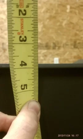

And steel is sheet until it exceeds 6mm which is 0.24 inches. So our Englanders are sheet metal too except the top plate which is supposed to be 0.25". Or is it? See photo.
My BK is really thin, looks to only be 0.125" on the sides.
  • [Hearth.com] Melted furnace back

he said his was 1/4" which is .25 more than the .21 but both are fine i am sure. And yeah that looks like 3/16 to me but cant tell for sure with the edge roundover
