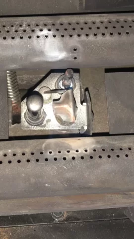

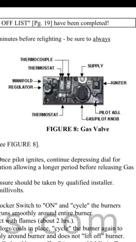

Will check the other unit. I was basing the idea this was the thermocouple as the diagram shows it that way but I’m very happy to be wrong.
So the larger probe on the left is the Thermopile?
Correct. It generates the necessary mV to keep the burner going, generally 550 +/- 25mV
Think of it as a "pile" of thermocouples.
Thermocouples generate the necessary mV for the pilot, generally 28 -31 mV.
Both of them generate mV to open electromagnets allowing for gas flow.
The themocouple in YOUR pilot assembly looks to be toast.
