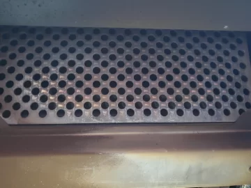

A week or so ago we had a day in the 40s so I let my stove go out and cleaned it. Anything look amiss? I just lightly vacuumed the face of the catalytic with a soft brush attachment.
There was a bit of hard thin black stuff that flaked of the upper sides and back. Guessing that's creosote.
The stove was new in fall of 2024. [Hearth.com] Mid season clean out[Hearth.com] Mid season clean out[Hearth.com] Mid season clean out[Hearth.com] Mid season clean out[Hearth.com] Mid season clean out
Yes that’s creosote. Mine gets the same thing in the back of the fire box. I spray it down w some creosote remover (liquid) about once a week right before I light a fire. Then it usually scrapes right off

I would make sure to check behind the vertical firebricks next time you clean again to make sure there’s no buildup behind them if you didn’t this time. Could potentially cause rust issues if never done and there’s creosote hiding back there.

Cat looks good.
I would burn a hot fire a bit more often to burn off the shiny creosote. Wide open throat for two hours once a week is good.

Check another thread here somewhere where someone asked about the "creosote remover".
Those usually contain phosphoric acid, and Phosphates is something the cat doesn't like at all.
