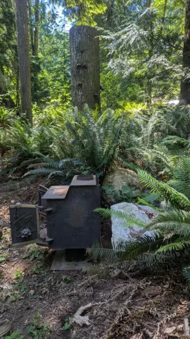

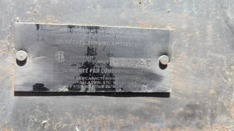

I got this stove and there is a CSA label on the back with a serial number, but no model or clearances. There are heatshields on the back and the stove looks double walled. Does ayone know what model it is an if there is an installation manual for the min clearances?

Can’t tell by pics, open doors would show air intake system; Stove body and pedestal looks the same on these two models.
If 7 inch outlet, both air intakes rotate drawing air through doors, which is a Teddy Bear.
6 inch outlet, only left side knob will rotate which adjusts air with a flap across front behind doors. This draws air up through pedestal, which is a mobile home certified Goldilocks. (See manuals in sticky section at top of Fisher Forum Home Page)
