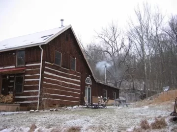

Did you ever get this resolved? My flat roof only had a 3' section of chimney when I bought it for a total height from flue collar to top of about 8'. I added a bunch more and used a brace as pictured. These are not "wires" but a rigid brace and sold by Selkirk (I use Selkirk pipe). The ceiling support for these systems is more than adequate to support this much chimney - if I had a gable roof, it would be the same system with no additional vertical support. My last house had something like 12' of pre-fab chmney over it. If you have some other brnad of ceiling support, you might want to go with Selkirk/Metalbestos with a brace like I have - it lag bolts right through the metal roof (or shingles) into the rafters - it won't leak once you seal it with silicone or some other crap. I don't think all is lost, but you might have to change out the ceiling support. Good luck.

I'd try it with the 10' of pipe. It may not be ideal and may be sluggish in mild season burning, but there's nothing to be lost by trying it. It's a straight up pipe from what I can see, so it may work ok. If not, I don't see any reason why another 3ft couldn't be added. A standard roof brace or guy wiring looks possible here.
