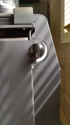

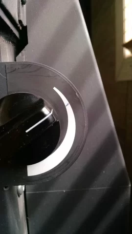

So I just went to adjust it following these directions and it’s already set up like that
I kept the door open until the fire was absoluting raging.
Closed the door and with the damper wide open the fire died down drastically.
Ok. I need clarification on something.
I followed the directions for setting the damper that BKVP posted and it was set up like that already.
But one thing that got me thinking was the white line. When turning the know down the white line will go way past the #1 before stopping. Should I be using the white line as the pointer for lack of a better word and putting it between 2-6 o’clock? I have basically been having the white line pointed at about 10-11 o’clock but turned down not up to get to that point. The screw in the know should be pointed at like 5-6 the way I’ve been doing it

I just found the manual online. It looks like the white line is the pointer. So basically I have been turning the stove way down like past 0 if that’s even possible. This explains why the stove has been dying out. I was using the other aide of the knob as the pointer, the side with the Allan screw in it. The white line is so worn down that I can barely see it was a flashlight pointed at it.

The white line on the knob should be pointing down or at 6 o'clock when at wide open. At the same time you should feel the stopping point.

Ok. I have a problem then.
My knob is set like BKVP says to do.
Now with that being said. I can turn my knob about 350 degrees before I hit the stops.
Also my knob looks a lot different. The white line is not on the face. It’s on the top.
Turn it clockwise all the way till it stops. Loosen the screw and rotate the knob till is pointing at 6 o'clock. Be sure the shaft doesn't move during this process and tight the screw back on. That should be it
Still it is the same process.
Reactions: Doc C
Already did this. It was already set like this. But it still rotates almost all the way around
If it stops at 6 o'clock clockwise it's ok. Counterclockwise it does go real far and that is ok also. You just need to find the setting that works for you into the range of the sticker or numbers according to the system you have.

I think it’s because I was using the wrong side of the knob to set the temp.
Couldn’t see the white line. I’ll experiment more when I get back home.
Yes, the knob will turn vastly beyond the actual low point. Remember 2-6 is the effective range of use....

Where I think I got messed up is my white line was worn away on the knob.I had to really search for it when I was following your directions to calibrate the knob.
I was essentially using the alen head side of the knob to set the heat range which was putting me 180 degrees BELOW the setting I thought I was on.
