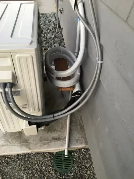

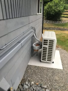

Here’s what I did with the extra. You can’t cut it and you can’t coil it vertically so I did this thing behind the outside unit.

The horizontal coils are definitely the way to go, there is a lubricant in the system and if the loops are vertical the lubricant can separate out and collect in a low point if the loop is vertical. That said its probably not that major of issue as my 12 year old minisplit(cooling only) was installed by a "trained" Mitsubishi rep and he had extra and coiled it up in horizontal loop. I had not researched minisplit installs at the time but he definitely did not follow standard practices and yet it still is running.
thought they were disposed to be install so gravity gets the oil back to the compressor??? So a flat helical shape is best????
Reactions: stoveliker
Correct, that’s why I did that. Horizontal coils are required by the installation manual for just that reason.
I think there is a misunderstanding regarding the naming of the orientation of the coil: its axis or the plane in which the coil lies.
I think you all agree.
Reactions: EbS-P
Sorry for the confusion Horizontal coils are the way to go. I will correct the post. I swear its minor dyslexia sometimes, as I tend to transpose typed words on occasion.
Last exam had a question where it said the coil was laying flat on the table. It was not clear enough but hid I said plane of the coil parallel to the table top plane there would have been more questions
Sheesh! Way to stop an argument where everyone swears they’re way is the right way!
Now if I only was able to apply the same method to myself...
Horizontal coil has lines stacked vertically? Ha!
That’s why I put up a picture. You can bet people argue about whether it matters because it’s a pain in the butt to lay the coil flat as directed and the manual even has a picture.
Even mrcool’s installation videos show the extra being coiled vertically behind the compressor which is contrary to the directions.
