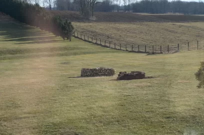

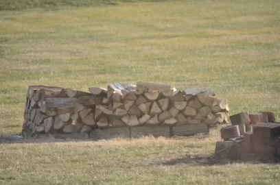

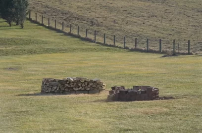

A little off topic, but I started my poplar Holz Hausen yesterday...not as pretty as some, but my radius is only 9' and my splits are a tad on the bigger side. Next ones will be 12x12 and oak/hickory/cherry.
