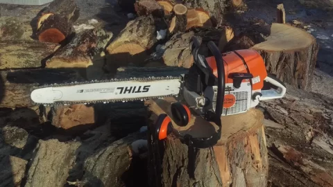

My 461 started cutting crooked
Roundgunner
Feeling the Heat
Nov 26, 2013
360
Rural CT
I have been doing 36-40 " oak for a week and my big saw won't cut straight. I have paid particular attention to the length of the teeth.
It is not in rough shape or old. I need 24" lengths and sometimes on a 40" cut it is 6" different top to bottom. It sux.

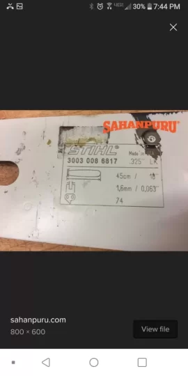

That leads to a question. The original bar is aparently worn. But in the picture it doesn't look in too rough of shape. And the chain looks to have lots of life left. Was the chain replaced with the wrong size? The bar and chain combo should be stated on the bar -
A bar should be good for using up one chain, and a lot of times more depending on how agressive they are sharpened.

I buck to 24 inch. The ones she is next to were not the biggest. They were about 5 foot. The biggest was to heavy for my Kubota to lift more the 2 feet high. It's rated at 1000 pounds! The photo of the saw was an older one but it still in good shape. The width of the slot / rail was the problem I think.
