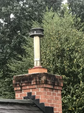

They also are coming back to install a chase cover I guess. I’m getting water in the chimney that’s getting to the insulation around the liner. They should have installed that in the first place? My ashford was installed 10 months ago. I am wondering why I’m having issues already.
I also asked for the extension to be Insulated, as you can see it’s rigid. So that’s getting fixed also.
Just trying to max performance...
Your chimney crown likely does need some attention. I’m not sure a chase cover is in order though.. if they do, make certain it’s stainless steel.
That extension is very odd looking. I see lots of red silicone gooped around but no storm collar. Any chance you can get a picture from the roof?
We used to call an installation with caulking all goobered up like that a BUM (butt ugly mess). Maybe contact a couple good reputable and certified chimney sweeps for a look and bid on fixing this and putting in a block-off plate.
I am trying to find someone to do those things....the installer is offering to take a look and fix anything that has to do with the liner for free...They also said they would help me correct this.
Can anyone help describe what I should have installed up top on the cap? After all the masonry repairs are done.
