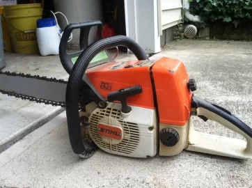

I picked up the saw this morning, along with its case, an old bar, several chains and an extra spark plug. Aside from being seized (and it is very seized), the saw looks like its in great condition. The original protective plastic film is still hanging on to the badge on top!
I had to leave the saw behind in Ohio, along with my dog, while my wife and I drive to Minnesota for a friend's wedding. It will be a week before I have it back home where I can start fiddling with it. Meanwhile, I am wondering why it siezed; it looks so well cared-for.
