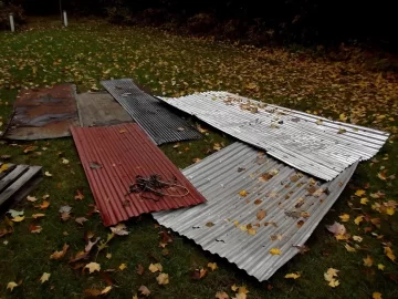

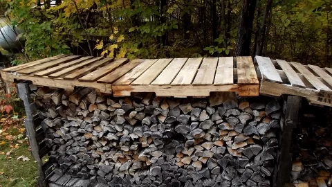

I did that just a few weeks ago. I had been covering the piles with old tin that I had salvaged from our town dump. The stuff has a bunch of holes in it and rain and snow was always leaking onto the piles.
I live near a lumberyard that gives away pallets, so I brought home a few and set them on top of one of the piles. Northern Tool had 4'x18' tarps for $4.00, so I got a couple of them too....
Old, holy tin...
[Hearth.com] My idea of covering wood with pallets to create overhang.
Pallets on the pile....

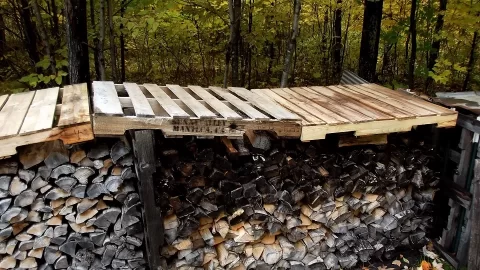

Covered with tarp and secured with bungee cords through pallet
I'm not worried that the winds will blow the pallets off the pile, but we'll see how it goes. I used a few more pallets on the adjoining pile, and used the best of my scrap tin and bungee'd it to the pallets....
