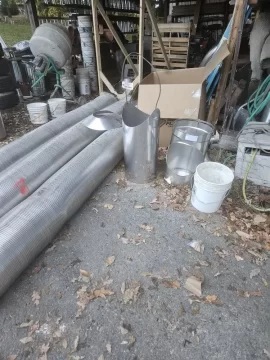

This is the fun liner in store for tomorrow. And yes that is a 5 gallon bucket sitting next to the tee body.

Be safe, looks like some height might be involved.
We have a crane for this one. I don't see how I could handle 40' of 14" liner otherwise
Reactions: Osage
And we thought 8" was big!
We can only hope they’re burning dry wood. Lol
Lol that would be gas
Is it a mega church or are they trying to heat the large cubic foot area in 10 minutes?
It's a big place with a youth center gym basketball court etc etc
Would make one hell of a didgeridoo!

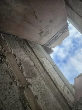

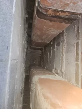

Here in the project for today. Remove framing going through the chimney then pour a crown. Fun

Pole saw or do u climb down?
The last picture is up from me inside. I had to cut it back atleast 2" to get thick enough chamber tech in over the ends
Oh i see now, 2x4 cut is recessed behind face of the blocks. Is Oscillating tool the preferred tool for this?
You should gather these pics for a sticky thread titled, Why do I need an insulated liner?” Most never see the things you see often.
