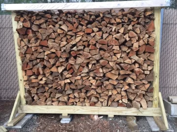

I use a system similar to your toppled single stacks. I use a 2x4 on the bottom perpendicular to the stack and connect that to the side "wall" with a piece going diagonally and then build a little roof with clear plastic to top cover without blocking much light.
[Hearth.com] My three types of stacking methods and which seems to work best[Hearth.com] My three types of stacking methods and which seems to work best
I get a little less than half cord for an 8' long x 6' high module and so far so good stability wise. It's a bit overbuilt but I'm in the burbs and neat looking stacks in a small area that dry fast and don't fall over is important.

Agreed. I like looking at what other people have done for some inspiration. The rack I showed earlier in the thread was inspired a bit by your Solar kiln thread which I checked in a lot on. I liked having a higher stack like yours and modified it to fit my needs and (lack of) carpentry skills. Instead of clear plastic for a kiln I used clear plastic for the roof. Working good so far as I hope yours are as well.
