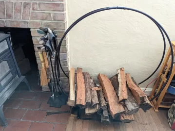

I've decided to buy an indoor wood rack and place it 18" from the side of the stove. Thus all wood burned will have spent one day near the stove to dry it out a bit more than the 23% average that I'm now getting with the new stuff. Not perfect, but probably an improvement.
It seems to help a bit, but it's not a magic bullet.
