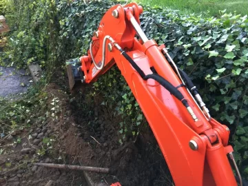

Clearing out an old driveway garden that was once a great producer of thorns, weeds and my favorite... poison ivy

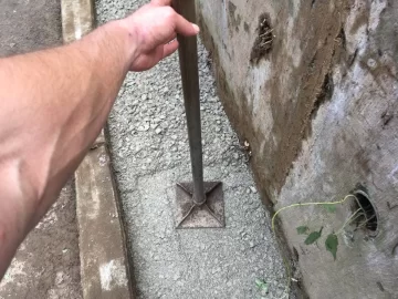

Putting in quarry process in layers and tamping in between to make sure I have a solid working base, laying the cement blocks and making sure they are leveled & square with each other before locking them in with more quarry process, laying pressure treated 2x6's to make sure the foot print isn't to big

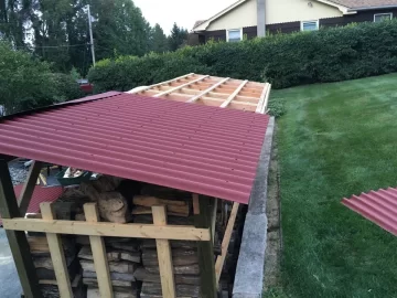

Started the second "bin" this week, I've been able to work 2 hrs a day after work, I should have the whole roof and over hang done by tonight, and the shed loaded up by mid morning Saturday.
After this is completed I'll have 2 more bins to go to complete my mission of having 8 cords under permanent cover

scag 48" walk behind lol, when I'm not processing wood I'm mowing the lawn..love my lines. The shed is 10ft wide by 5ft deep, the front opening is 8ft high and tapered to 7ft in the back (technically 6ft 6" but the curb / garden is 6" higher than the driveway)
