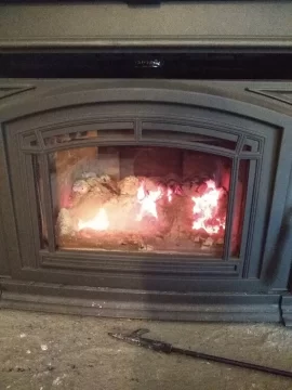

I’ve read a few cat owners make the claim that noncat stoves only provide 3ish hours of usable heat, and then all you have is coals till your next reload. I have not at all found that to be the case with my noncat. For a while now, I have wanted to prove this out by throwing on a load and measuring the stove temp every 30 min or so for the full load. I wasn’t able to do that today… but I did note the time that I loaded the stove (8:00 AM), and circled back at 3:00 PM (7 hrs later). The stove is currently at 395 degrees F. A picture of the coal bed is attached.
The whole load has been with the air 90-100% of the way closed. If I had opened it up further several hrs into the burn, it would certainly be hotter than it is now. However, the stove is currently keeping our downstairs at 68 degrees (has been between 67.7 and 68.5 for the past 5 hours), so no need to increase the stove temp.
Anyways, hope this is helpful for people doing stove research and sifting through all the claims that you find on hearth.com :)

Not sure what others have said but I call Tube stoves Cycle burners, meaning you have peaks and valleys in the temperature pattern, that accurately describes them better than by xx amount of hours since stoves vary in size and conditions can dictate it to be run harder than other times.
When you do your test you will see the load will offgas giving a high temp from the secondary burn then the temps will settle down once the offgas is done and you will go to your coaling stage which will further reduce your temps till you do your next reload, then repeat.
Cat stoves burn more even over a period of time since the heat is produced by a chemical reaction from the smoke and heat.

Agreed. I understand the basic progression. However, it seems like I've read some people make the argument that the peak of the noncat heat cycle is very high and of short duration, and then the stove doesn't put out much heat until you re-load. And similarly, the assertion is made that house temps follow the stove temps and soar at the beginning and then crash until you load again.
I could be misremembering what I've read - too lazy to sift through forum threads to try to find out...

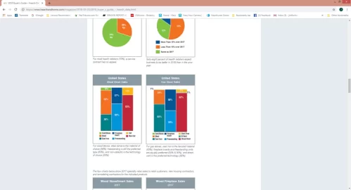

The forum can become slanted sometimes as members that want to talk about woodstoves obviously are enthusiasts much more than many everyday users. We really try to give all sides to the different burners. As I was looking through data from HPBA , I found that CAT stoves make up only 17% of all wood stoves sold in 2017. So keep in mind 80% of the people that visit the site never sign up as members. That is why a balanced approach is best and keeping in mind the vast majority of wood burners don't burn CATs.

Holy crap! Cat stoves make up 20% of sales?! I would never have thought they were growing the market share so fast.
Let’s spin that data a bit. I could call cat stoves the fastest growing market segment (assuming it was lower before) and that many people come here looking for advice on which stove to buy. Growing numbers are deciding that long burn times are important.
Wow, 1 in 5 new stoves are cat stoves. That’s really amazing considering that only a couple of “off” brands make them.

Nice, how mouth cubic feet is your stove?
