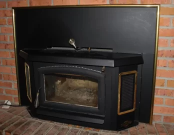

I was hoping someone might be able to tell me what model number this stove is. It was sitting unused for years with no chimney cap before I bought the house. Now that it's snowing, it might be a good time to break the rust free and set something on fire.

Should have mentioned if it is a BV4000, it will have a catalyst in it, and will most likely need cleaned before using. Check over the manual for proper operations and cleaning.
Reactions: begreen
You have a nice insert there, the BV4000 was ahead of its time, one of the first "hybrid" stoves out there mixing secondary air with a cat.

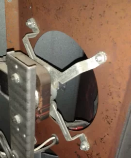

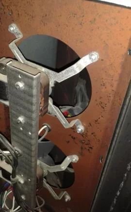

The next problem appears to be that one of the plastic fans broke off and melted to the insert... also missed in the inspection.

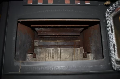

When you have time, I would work on the set screws that hold the damper control on the damper, get them loose, and pull the rod all the way out and clean it up, and.. from the way it looked, get the damper out and get it welded. It looked to me like the only thing "connecting" the damper to the bar that slides it is the shoulder of the original weld.. may work forever like that, may slip out/over at a very bad time..

I thought about trying to fix that weld joint on the damper, but I have no idea how to get it out of there without pulling the entire unit out from the wall. Is it possible to tip & pull the damper down inside the fireplace once the set screws and rod are removed?
As far as the cat goes, I would like to say it looks good but I don't really have the background to make that call. I pulled it out and blew it off with an air compressor, although there wasn't really must dust in there to blow out. I'd like to say it looked pretty clean. I've had a fire going all day with the damper closed, so I guess it's working to some degree, however whenever I open the door smoke pours into the room. As a workaround I've been opening the damper, cracking to door to let the air flow in, and then adding the fuel once the fire starts back up. I don't know if that's the book answer, but it seems to work.

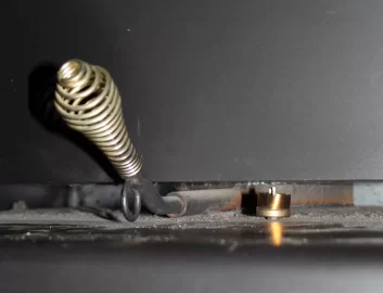

I guess I should have finished reading the manual. I did read the part about the temperature gauge, but what's shown in the manual and what's installed in mine are different. All I have is that little coil thing sticking out of the top (partially shown in IMG_4347 at the top of the page). It looks like a cigarette lighter on a stick.

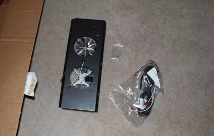

Well, I broke down and placed an order with A1Stoves a month ago for the LB101495 Fan Assembly Kit, and it finally showed up today with only one fan blade. Hopefully it doesn't take another month to get a replacement blade.
In case anyone else is looking for an image of the fan assembly kit, I attached one here. Maybe I'll be able to post some complete images with two fan blades later.

Related to the same stove. Posting in case it's of use to someone.
