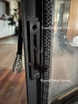

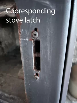

I think I may have found the culprit here. The latch plate mounting screw holes are countersunk which means it should have flat head machine screws, this one was likely swapped by the previous owner and they used round head screws. What happens here (I believe) is that the round head screws from the latch plate (door) meet the round head screws (stove body) which prevents the door from getting 100% tight.
In a quick fix, I've picked up some flat head metric screws this morning to swap out on the existing latch plate (door), and have ordered a replacement latch plate and latch.

sounds and looks like you nailed it! Well done... Please update after you make the fix as it's good info in case someone else has a similar issue

Thanks for checking in, and my apologies for not responding to this post sooner. I've been meaning to take some photos to better describe the solution, but the description below should suffice.
Essentially, the latch and latch-plate were replaced by the previous owner, and instead of using flat head screws, they used pan head. They also had these same screws on the corresponding latch-plate on the stove. This created an issue where the heads of the screws were bumping into one another, preventing the door from fully sealing.
I replaced the latch and latch-plate (door) and re-drilled out the taps on the corresponding latch-plate (stove) (they were rusted and seized) and replaced with flat heads. I also replaced the door gasket.
The door is almost 100% sealable now, except my problem is the the hinge plate is very slightly bowed, as if someone was hanging on the door. The paper test works well, but not perfect around the entire door. A problem to solve over the winter.
