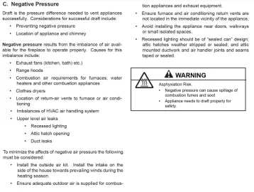

It's not really the walls that need sealing. If you are going to improve the problem you would have seal the ceiling and attic area. Any sealing of leaky penetrations to the attic would help, stairs light fixtures etc.
Have you ever tried to start the basement stove without the first floor stove running? Is it worse or better? I imagine that loss could contribute to negative pressure too.
Quadrafire has a good advisory page on the topic of negative pressure.
