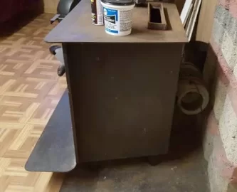

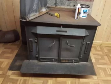

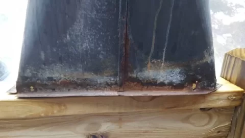

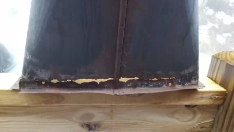

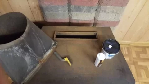

I recently bought a house and the previous owner left a wood burning stove in the basement. There is a rectangle to round adapter that comes off of the stove to the 8" flue pipe that has multiple holes along the base that needs to be replaced. I've search the internet and cannot find a new one. Anyone know of place that would sell this? The base needs to fit over a 3" x 15" stove collar and transition into a 8" flue pipe

First, thanks for the two quick replies and suggestions. I could not find any indication of stove brand.
Any suggestions on how to secure one of the above new adapters to my stove? Would furnace cement be enough?
bholler
Chimney sweep
Staff member
Jan 14, 2014
32,304
central pa
No you need a mechanical fastener. Some furnace cement wont hurt as well but you need screws bolts or rivets also

Looks to be a Buck or a Buck Clone, the damper rod usually is taller than that to fit the Buck plate on it if it is a true Buck stove.
How to identify model: https://www.hearth.com/talk/threads/old-buck-stove-information-one-stop-resource.125611/
That is a sketchy looking install, way to close too that rear wall and that pad isn't doing you any favors either. I would have a certified sweep come out and do a run through of that setup before using.
begreen
Mooderator
Staff member
Nov 18, 2005
100,853
South Puget Sound, WA
Agreed. This is not a safe installation. The stove appears to be an insert. If this is the case it is NOT safe at all to place on a floor, even on a hearth pad. It is designed to go inside a full masonry fireplace. The cement bricks in back are more psychological protection than actual. This is dangerous, do not proceed without some guidance, hopefully from the manual.
