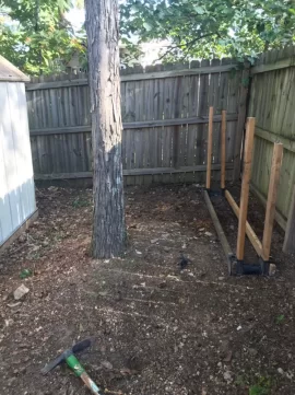

I’m storing the wood about 50 feet from my home. My whole lot slopes so it’s hard to find a decent spot to put the racks.

If you are planning on storing wood outside for 3 years either open air or under a tarp I would make sure those 2x4s are TREATED, especially the ones on the ground. Nothing like your wood stacks giving out come 2nd year fall or spring in the wet.

I’ve filled that one up, but decided to build a shed far from the house. I’m trying to decide on plans now... but will post what I come up with. Mainly the whole tarp thing would drive me nuts... build it once and it’s done.
