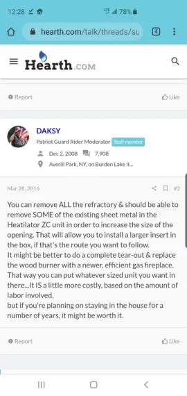

So I currently have a heatilator EC36. I am looking into placing a wood insert into it or a pellet insert. However you can't beat the look of a real wood fire.
I have read in some places that you can remove the refractory panels and in other places read that you can't. No solid answer to be found.
I read in one post that the Pacific Energy Kodiak 1700 will fit but have not seen anyone do it.
Looking for info and some helpful advice.
Thank you in advance.
From your manual...Seeing as a wood burning insert is NOT listed in the system components,
you CANNOT safely install one.
[Hearth.com] Need advice with insert
Ok. Just trying to clear things up because of the conflicting responses in regards to the EC36.
I get that but regardless of any previous responses the manual is clear
