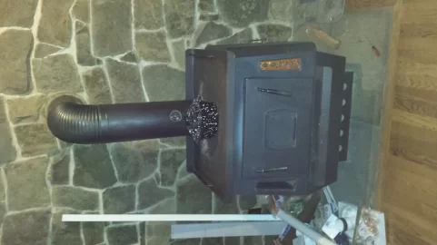

The Blaze King has an 8" pipe.
  • [Hearth.com] Need Advice - Wood Stove for under $3000
And our house was built in 1980, but It seems very well built. There is 2x6 exterior framing (rare in MD) with significant insulation. The windows are older and need to be replaced though.
That's a bit tough as only very large stoves need an 8" pipe and those may be a bit overkill for you. A BK King would probably be ok as you can run it on low for most of the time.
What is behind the thimble? Is that a masonry flue? Does it have a liner?

I live in Howard County. I saw a Regency (not sure what model) at Ace Hardware that seemed reasonably priced. I have plenty of dry/seasoned wood. The previous owner had a lot of oak cut and stacked when we bought the house. I also took down a dead locust tree that I cut and split. I checked freshly cut pieces with my moisture meter and it had 13% moisture in it.
I went on the roof a few weeks ago to clean my gutters and checked out the chimney while I was up there. It is a terra cotta pipe... 9x12 I think.
With that info, I would run an insulated 6" liner down the chimney and convert to 6" at the crock/thimble, reason being it is easier to clean and will draft better, that will also open you up to a myriad of 6" stoves to pick from, one was already mentioned, the Englander 30 NC is a favorite budget stove here, can be sometimes had for under $800 brand new, so in theory as previously mentioned you could get the whole setup and be within your budget.

I was told that I should just run new 6" stove pipe to an 8" increaser at the thimble. I'd rather buy a better stove and not spend any money on the chimney/liner if it's not necessary.
