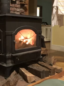

Top part sagged out last night.
I immediately let the fire go out and when it was cool I was able to replace it temporarily until I can locate the correct new one.
Btw- a popsicle stick works well for this job
I know this is not ideal and I’m trying mightily to locate what I need ASAP.

Is that the gasket hanging there and not a crack in the glass?
