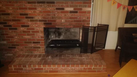

I first want to say I am a complete NOOB, I have never had a wood stove and I have yet to use our fireplace. I have about 1,800 sf.
I have a corner fireplace which has a serious draft problem and can not be used. In the last six years I have placed a blow up pillow up into my flue to stop the draft.
Well after YEARS of saving :), my wife finally gave me permission to do something.
My options are either install a insert or get a wood stove that would fit in my opening. I only want wood, I do not want pellets.
Because it is a two sided (corner) fireplace, I don't think I want an insert... what is your opinion? I think if I get an insert I would have to redbrick the side or at the bare minimum put a steel wall on the side that is opened.
The height of my fireplace is 27.5", the width is 40" and brick area in front is 20", I never measured the depth.
I have a small child and I am worried about emissions. Basically I am looking for an ultra low emissions wood fire stove or insert (most like a stove... but I am opened minded).

Don't discount inserts. There are a lot to choose from. You could leave the side exposed, or use a screen, plate metal or brick in the open side.

How it looks is up to you and the person doing the work. Buck is only one option. There are many inserts that would fit there, but very few stoves shorter than 27.5" tall. There was a good example several years ago where the fellow bricked up the side, then painted all the brick white. It finished nicely.

I would even consider doing an insert and then covering up the hole? I just don't know what will look better, with this type of fireplace.
If I did get the Nova it says 19.5" in depth... my hearth is 20"... based on this I am not sure if it will work. How much of a hearth do you need and how much can I recess a stove into my fireplace, keep in mind that I will use a blower. And it sounds a lot cheaper to do a damper area block-off plate rather then rebricking a wall or putting on a steal plate... BUT I still have not wrote off inserts.
I do like the Napoleon EPI3 Oakdale Wood Burning Fireplace Insert.
The stove or insert would need at least 16" of hearth in front of it. That may not be a big deal due to the fact that this hearth is raised. A simple hearth pad in front may suffice. More important may be the alignment of the flue exit with the chimney flue.
