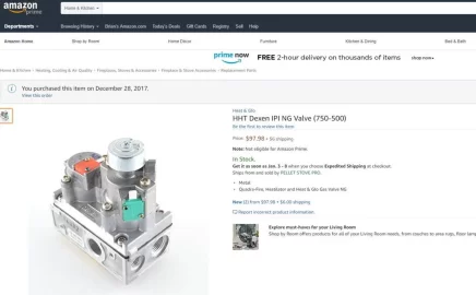

DAKSY... YOU are CORRECT! I was able to use 2 AA batteries in series and test.. When tested the pilot side solenoid does make the CLICK, i.e. open, but the MAIN doesn't.. So I would say the Solenoid is BAD... Grrrr... Houston... we have found the problem... :)
DAKSY.... Thank you so much for taking time to assist your common fella...

Very happy to UPDATE that I received the NEW valve and installed and everything is working wonderfully.. So there you go.. Also added the fire glass and left the logs in the garage.. ;) Big THANKS to everyone that makes this site awesome and helpful.
