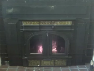

I bought one of these off craigslist for $350 3 days ago, and now see one closer to me for $50 (not as nice shape). I like the looks and the flush mount, and was happy with the heat output. I think the fan could be more powerful though. Air doesn't kick too far forward. Most heat is felt within a foot or so of the stove.
Two problems I have with this unit:

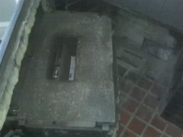

1) Fire exhaust is too far forward (although the complaint above says too much of firebox too far back). I'd probably have to rip out my damper and maybe even some bricks to get a direct up flow. Two of the five inch deep (by 11 inch wide) exhaust is directly below the metal under the masonry two front of my fireplace. There's only 3 inches between the top of the unit and that metal sheet too. So if I try to exhaust duct this thing, it's got to go back two inches before rising three, a five inch 90 degree would take at least five inches. A 45* would be better I guess, but doubt it would turn two inches in less than three too. (All of this before any double-wall or anything like that. I'm envisioning something like house ductwork with a single layer of sheet metal.) Round duct is simply not an option. (I know I need to research this, and the ducting options.) As a result of my "slammer" installation, after about 24 hours of burning, I've already got creosote on the FRONT of my fireplace. Now I see why a slammer installation is not exactly safe.
2) The fan is REALLY loud. Now the fan doesn't even work. I pulled the plug on the fan this morning (which I just had running down my ash trap into my basement) when the unit was cold, and then plugged it back in when the fire got hot this morning. The fan was louder, and not kicking air. I assume what was going on was the exterior fan must have been running (I guess this fan is for cooling the fan motor), but the big motor for the room circulation was struggling to move at all. This was a bummer, but not the end of the world since I was thinking of trying to replace the noise maker with something a little quieter.
(Of course I also see that folks say this unit is total junk anyway).
This morning I pulled the wood, cinders and ash out (metal bucket with lid of course), and pulled my "slammer" forward to check out the fan, and hopefully get a part number off it. No luck yet, as it looks like I need to tip this 500 lb beast on it's face to get the motor off. I'll try to get that done before 5 PM today, so I can search stores before they all close for the weekend, but I'm not hopeful.
So now that I've learned quite a few things in only 3 days, I'm starting to wonder if I should upgrade this stove. I previously thought they were all just metal boxes, with fans, but now see how complex they are. I am committed to an insert, but hate the idea of spending $2000 on a new one. It seems that it will take over a year to get that return-on-investment back. On the other hand, piece of mind and knowing my family is safe is worth quite a bit.
Do the members of this forum suggest I:
a) get a new insert, somehow, somewhere? If so, I'm in the Philly area, and willing to go get the stove
b) just get (I) a new fan (or jsut fan motor), and get (II) some ducting to get the exhaust connected to my clay lined 45 foot chimney (that my chimney sweep had said would be fine (i) without a liner, and (ii) without connecting the unit to the chimney (aka "slammer" installation).
Fix it, or buy a new one?
info on the stove:
(broken link removed)
Thanks,
Mike

There are AT LEAST a couple of inserts for under $1000.00
Drolet builds one, and Century builds one:
(broken link removed to http://www.drolet.ca/product.aspx?CategoId=7&Id=428)
(broken link removed to http://century-heating.com/product.aspx?CategoId=7&Id=522)
Englander builds one too, but I'm not sure on the price:
http://www.englanderstoves.com/13-nci.html
http://www.englanderstoves.com/50-snc13i.html
http://www.englanderstoves.com/50-tnc13i.html
You can also download the owner manual to see if it's going to fit into your existing fireplace.
Also, these inserts should have a 6" round exhaust exit, closer to the back of the stove to make liner installation easier.

Update on the Vermont Stove Company - Shelburne: I really like it... especially after running a VC 0044 (with bad seals and a busted left fan) last year. I bought a second VSC Shelburne for $50 last year. (Yes I own 3 early 80s inserts.)
The weekend after Christmas, I swapped Shelburne fans, and I'm up and running again. I cut some thick galvanized HVAC sheet metal to assure the exhaust on the slammer install is directed back to the fireplace flue, and started burning again. I'm three days in and ready to shut down due to green wood. Regardless... I really like this stove. Maybe it's a great stove for a noob like me to learn. I've got manuals, and a parts stove if anyone ever needs stuff. Please let me know.
