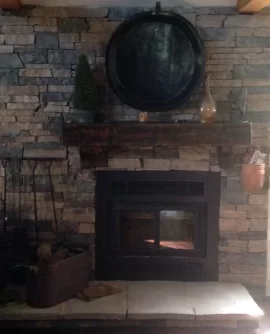

Thanks for the update DSK and well done. The Kozy is a good heater. Did you duct out some of the heat for better distribution? Any possibility of a picture or two of that beauty?
Sure thing. This is what the install looks like. Was able to preserve the majority of the stonework and the blend in to the new opening that I framed in.
We didn't duct in the heat, but have 2 ceiling fans in that room that move the air quite well. It keeps the living space toasty and the bedrooms cooler- which we like.
