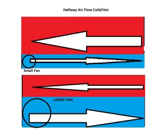

Small Fan close to the Ground Cold Air Flow vs Tall Fan.
Objective is to get a better situation for warm air flowing back to where you need it.

Thanks, that makes it easy for me to understand.
Maybe my box fan was just to big and moving to much air?
I have been told less is more.................If you cant feel air moving on the ground 5-7' away, is it still doing its job?

I second the idea BeGreen had.....the fan blowing down the stairs should be low at ground level and a warm flow will flow at the ceiling level up the stairs to your upper level. Its important to keep that separation of cold air low to ground warm air flows up high. Thats the reason for the small 9" fan sitting on the floor.
If the box fan is on low speed it should be fine. Are you saying you tried this last season using a thermometer to check for temp rise in the hallway? Was the ceiling fan running at the time?
I think you want the fans on low speed as well, just enough to augment the natural convection. If that furnace-room fan that bg suggested ends up blowing at the top area of the doorway where the the warm air is trying to exit the stove room, maybe you could try a desk fan at the top of the stairs and angle it down the stairs....might preserve the natural convection pattern better. I would certainly exhaust all the possibilities of move air with fans, before I messed with any of that ducting, etc. You also have to be careful that you aren't violating fire code when you start cutting vent holes.....your insurance might not pay off in the case of a fire.
