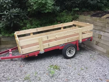

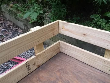

I need ideas on how to attach the corners together. I want to be able to remove the railings quickly. Thanks in advanced for any ideas.

Quick brainstorming...
You could put a 2x2 inside each corner. Bolt your railings to them, but use wing nuts for half of the job.
Or put some eye bolts through your railings so they line up in the corners, then use carabiniers or bolts to hold the eyes together.
A couple set of the hardware that's used to attach bed rails could work nicely. Very strong but easily disassembled joint. Probably the most expensive way to go though. Could probably also use some of those hook-and-eye or bolt style door latches as well.
I had thought about the 2 by 2s but wasn't sure how I wanted to attach them. I like the wing nut idea. I might go that route. Thanks for the suggestion.
Sorry just saw Shawn had the same idea....
I would use 90° hardware braces with bolts (removable). Be careful loading it too full with wood; the top of the rails will be too much.

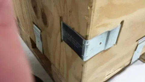

I think I found the hardware I want. I saw a returnable crate at work today with this hardware on it. The company only sales complete crates not just the hardware.
http://www.quickcrate.com/
I guess I will just have to wait until we dont return one.:cool:

Steel "L" brackets. Not the cheap stamped ones you get at Lowes but something bent out of flatstock steel. When the wood gets busted up you can unbolt the L bracket and replace the rail. You can bolt to the inside or outside of the two rails.

What you need are stake bed connector brackets. They are made specifically for this purpose.
Woohoo! Thanks. Need them for a couple of things.
Large door hinges would work as well. Put the bolts facing out and use wingnuts to tighten them down
