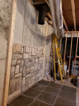

Bought a house that had set up for a wood stove in basement. We recently bought a drolet ht2000. I have no idea what would be the best connections to buy. Do I need an adapter, t, 90's, etc. I do know that we cant go straight up because it is too close to the wall. Any help would be great. Will be shopping at Menards if that helps.

Chimney pipe comes from roof all the way down to basement to what looks like the ceiling support box. That is where it stops. The last section does not have the crimped(male) section facing down which is what I have read is necessary.

That looks like a slip connector to me. Your pipe goes OVER it. Might not be usable at all due to under clearance to that sill plate. 2 45 degree ells would kick the stove out but that sill issue needs considered first.
That’s a metalbestos chimney system, the part hanging down is a DSAC, or dripless adaptor. It goes inside of your connecting stove pipe.
I’m afraid you don’t have enough clearance between the pipe and the wood sill plate though. Can you get a measurement for us?
