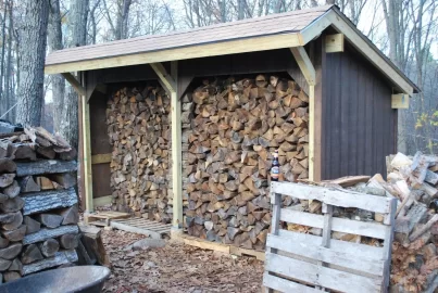

Check this out. Holds four cord +. Lots of pics of sheds out here too! Good luck.
  • [Hearth.com] NEED HELP.....Woodshed Design
Thanks Stejus! This is smaller than what I am considering but is similar in design to what I want. I would like an enclosed area on one end for yard tools, lawnmower, etc. Do you have a design that gives dimensions, etc.?

Wow - one of the nicest I've seen!

That's beautiful! Something like that would be perfect.
