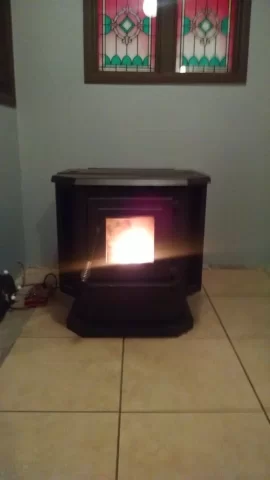

  • [Hearth.com] Need some Big Heat

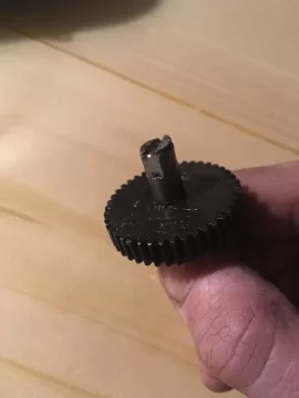

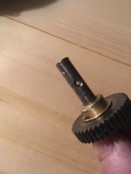

The princess may be coming sooner than I thought. The pelpro pellet stove took a dive last night. The shaft connecting the motor and auger completely broke in half. The first pic is the broken shaft and second pic is what it should look like. I replaced the motor about a month ago and suspect I overtightened the screw connecting the motor and shaft. Unfortunately the shaft that is intact is nearly impossible to attach to the rear motor plate. The pelpro was a solid machine with no major problems for 3 years. But it may be time to lay it to rest. On a dide note I measured my living pace that I heat and it is 2000 square feet. Feeling a little better about the princess producing enough heat.

That’s one of the reasons I favor wood over pellet stoves, there are less parts to break, no electricity required and you can’t ever get free pellets, but you can get free wood.
I hope you get back up and running soon.
Reactions: diverscale
I’ve never had to do a “firmware update” on my woodstove. Just sayin’.

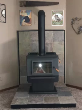

Got the princess in today! All said and done everything cost $4100. Temps should be around 32 degrees tonight looking forward to the maiden voyage.
You might wanna fire it up now, and open some Windows...
It's gonna stink a bit, curing the paint..
Reactions: lsucet

Congrats!
Is this the classic or ultra?
Temp was 61 in the House about an hour into my first fire, just a few questions:
1. After the stove was in the active zone I closed the bypass per instructions and ran the stove wide open. The stove is just past the maximum mark on the active Zone. Is this normal?
If I run a blaze king wide open does it operate just like a non-cat stove?
Forgot to mention princess Ultra stove with 2 year well seasoned oak.
