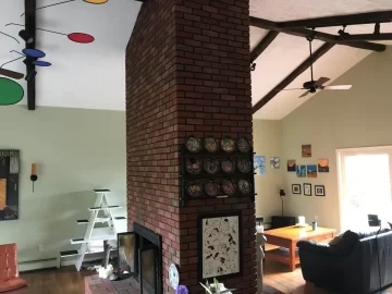

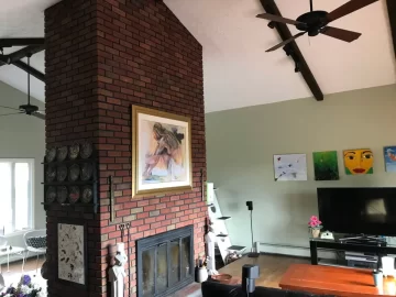

Hey guys. Here is the situation.
My daughter who is 25yo and her husband that 30 just got a house. We are in a middle of renovations here. Which is nerve wracking and expensive. They have huge double sided fireplace in a middle of the family room. Two faceplates, two huge hearth. Ill post pictures. We are about to put expansive stone veneer and granite for hearth on it and its major project. I told them to close one side and put insert on other because it's inefficient to keep it the way it is.. The inside is huge and can fit anything. OMG, they say I'm silly and it will not look good. Instead they want to redo it and keep two sided fireplace with new faceplates. Can you chime in and say if its inefficient and will suck the warm air right out. their main argument: previous owner says it heats good, it looks good. The daughter husband never dealt with wood and im saying they can use pellets if no wood heat desired
[Hearth.com] Need to hear voice of reason from my beloved hearth community [Hearth.com] Need to hear voice of reason from my beloved hearth community
Here is the pics

I'd tear that monstrosity down and put a freestanding over near the wall, opening up the space and creating a nice large open area.
At the very least put an insert in, and maybe cover the back side with some nice metal grating or cast iron, which would allow heated air out the back opening as well as the front.

It may heat well. For a fireplace.
Even the best fireplace burns five times as much wood as a wood stove. A crummy fireplace burns ten times as much.
There were three double-sided fireplaces in my extended family, when I was a kid. Two of the three had one face sealed off with slate, before I was born, so I guess that says something about how well they (didn't) work. The third was fitted with a dual-faced sealed gas unit, which looked a lot like the Supreme DUET. None were left open, by their three respective owners.
Remember, chimney cross-sectional area is sized to fireplace total cross-sectional area, so most of these traditional open double-faced fireplaces have chimneys that a fat man dressed in a Santa suit could climb thru. Lots of heat lost up those, exacerbated by the complete lack of a rear reflecting wall (thank you, Rumford).
I like Hogz's suggestion to just tear it out. It's not attractive, it's not functional, and they're discussing a major (and expensive) project to put lipstick on that pig. I suspect this option never came to mind, as I'm sure I might have overlooked it too, but it's one I'd consider.

It's holding big cathedral ceiling in a room, and it has oil furnace exhaust pipe going from basement

I'd make that opening taller and put a freestanding stove in it. That would be pretty and functional!
If they're going with a tube stove, that masonry pile would help smooth out the spiky heat in shoulder season.

An insert will be perfectly functional as well. Especially being an internal chimney any heat lost to the masonry will still end up in the house.
