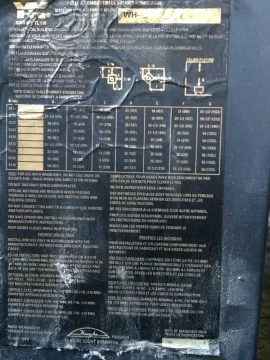

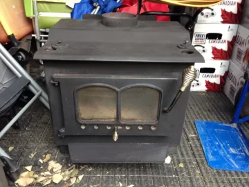

Hey everyone! Just bought a wood stove and I'm not sure which model it is because it's not checked off on the back. Any help would be greatly appreciated!
[Hearth.com] Need to know model # [Hearth.com] Need to know model #
Just guessing, maybe a Haugh S128? You're not the first one with this problem. They must have used disappearing ink on these tags. You could try contacting Century:
(broken link removed to http://www.century-heating.com/en/service-support/contact-us)
Thanks! It's a pretty small stove though so I thought it would be one with lesser clearance requirements. It's approx 22.5" wide and 20" deep
Also, that list is spacing from combustible materials, correct? I'm placing it where the wall is cement board with ceramic tile on top
The measurement is taken from the closest point on the stove to the first combustable material

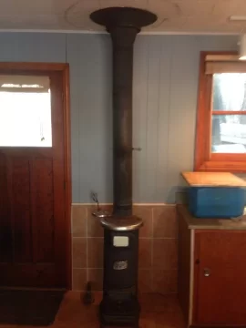

wow that's close to the cabinet to
That doesn't make it ok. you will need to check the clearances it might make it.
Well to i cant help you with which model i am sorry but looking at that tag the smallest side clearance is 14" which it looks like you will not make there but i cant tell for sure
After 60 yrs the odds of pyrolysis being an issue go up. We can't tell you what condition the wood is in just by looking, but those clearances are definitely not inspectable or insurable by current standards.
Well I looked into the approved wall board says it can drop clearances 66%. But a minimum of 12". That being said, I think I can get a foot from the wall and the cupboard with that siding. Will that not be acceptable at that point?
If you can get a foot With a proper shield you should be ok
