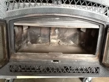

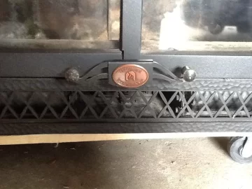

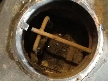

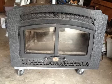

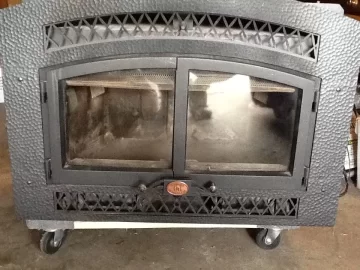

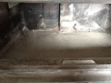

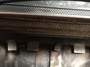

Couldn't help but to go out to the garage and clean up the insert a little and see what I'm working with. All the welds look great and from what I can see it will just need some new door gaskets and 4 fire bricks. Won't know about the blowers until I take them off and grease them up. Sorry about the crappy pics, they were taken with my iPad. All firebricks are removed in pics. Please let me know what you think and also if you see anything alarming.

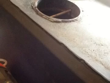

Update: so I went with the 5.5 liner and am so glad that I did. It took me and my brother about a half hour pushing and pulling to get it down the chimney. No way would the 6 have fit. After getting it down we stuffed the newly open space by the damper with roxul and put in the block off plate. Then put the appliance adapter on and pushed the unit in. Wow was it tight getting it all connected and screwed in. I had like 3 inches between the top of the unit and the fireplace which my hands and arms really didn't want to fit into. But after some shoving and yelling I got it in and secured with the L brackets you guys suggested. We then went up on the roof to cut off the excess liner which like 4.5 feet. Glad I went with the 30' liner instead of 25. Cut off the excess, shoved more roxul down until I couldn't then sealed up the flue with high temp sealant and put on the deluxe terra cotta cap and tightened it up. So after like 5 hours total the install was a success
