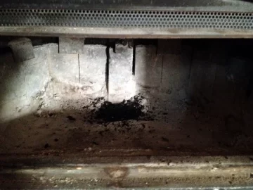

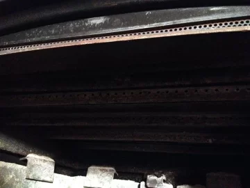

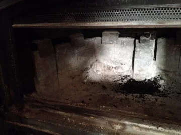

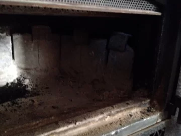

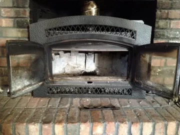

Hey everyone. I found what seems to be a good deal on a used insert pretty local to me. I have been talking with the seller about the insert and was told that he bought the house with this in it and hasn't use it since. Doesn't know much about it and is looking to sell it and throw in the stainless liner . First off I would like to know if the unit seems solid? I don't know much about it but from my research it seems to be a fireplace xtrordinair 33 elite fdx. I asked to see pics of the inside of the unit and will show you what I received. My real questions here does everything look decent? All I see is a few cracks in the firebrick but does that matter? Please let me know what you gather from he pics and if all looks ok how much would it be worth?

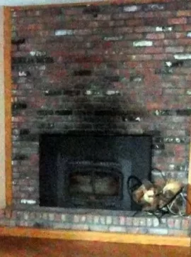

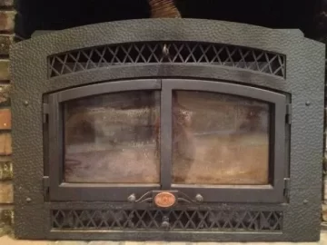

These are the rest of the pics. Let me know what you see and think about it

It looks to be in decent shape. A couple cracked bricks are no big deal. If there are no other flaws maybe worth $1000-1500 depending on its age. Is there a surround with the unit?
It has seen its fair share of use, I would put in an offer of $800 without the liner or $900 with it. I would explain that you are looking at needing new bricks, door gasket, rear baffle and new burn tubes. You don't necessarily need the burn tubes but I would price out a new rear baffle for sure, that way you know you will be good for the burning season, the baffle bricks should be inspected but they should be ok.

Thanks guys, he is asking 1k for everything. I would def offer a bit less because of the obvious reasons. It does come with the surround but it's only pictured in that one pic. Is their any way to check if the blowers are working without starting a fire? And thanks mellow for the manual. I am going to see how low he will go and throw in the things you listed to back up my reasoning. Will update you guys on what's going on. If I can't get it a bit cheaper I will prob just pass
It's worth $1,000. That is a great stove! That hammered front probably cost almost what he's asking for the entire thing! Offer $900 and he includes the liner. Those inserts are solid stoves and are very hard to damage. I'd buy it!

It's gonna be hard to find a better heating unit than the FPX! If it was me and I needed an insert, I'd keep it.
Agreed. All I see needing replacement eventually are a couple cracked bricks. Tubes look in good shape. I'd take out the blowers, clean thoroughly and oil the motors bearings. Should be good for several years of service after that.
When you get your eyeball on the stove check the sides for greying or whitening of the paint. And inspect the secondary manifolds on the sides for any sign of cracks along welds.

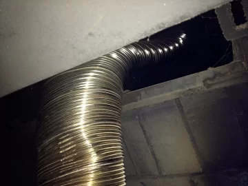

Sorry for the delay in writing back. I went to go take a look at the unit today and with all of your advice I looked at certain areas for graying or paint issues/cracks. All looked good and I threw it in the truck :) well not that easy butI took the firebricks and doors off to lighten the load a little. I need to replace 4 bricks but the rest looked fine. The door gaskets look like they need replacing as well but besides that all looks good. Got it home late so I didn't get a chance to clean it up and take pics but I will tomorrow and post some up. Back to the story..My brothers and I got the 450lb insert in the truck with no issues at all and figured the liner would be even easier. We go on the roof, take off the cap and there is no liner in sight? I tell my brother down below to just pull on the liner a little and he pulls it right out of the chimney. They had it shoved in there and ended just over the smoke shelf, maybe 6-7 feet or so. It falls onto the hearth and so much soot and creosote falls. Prob bc they can't really clean it that way. O and there was no insulation or block off plate installed so just a short liner going to nothing. I was a little disappointed here bc I was going to save a lot on a liner but this piece was useless. Just left it at the house since it was banged up and burnt a little at the top. Now bc of this though I walked away without the liner but with the insert and surround for a negotiated price of 500. Overall I feel like I got a great deal.
So now onto the next step. What is the best yet cost effective 6x25 ss liner to go with? Is 2 ply smooth wall worth it such as a flex king pro insert kit shipped to my door for right at $400. After that I should just need a good cap and block off plate which I will make myself. What cap do you guys use on a terra cotta clay liner?

Like I said, that surround was WAY more than you paid for the whole unit!
Whatever liner kit you end up with should come with the top plate and the cap. Some kits seem really cheap, but they don't come with any appliance adapters or top plate and cap. Not much of a kit at all really! You will most likely need a fixed 30 degree elbow on top of the stove. Every fireplace is different, but a 30 degree elbow is the most common adapter used.
