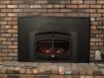

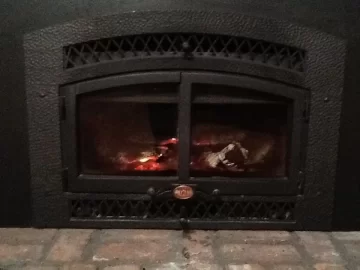

[Hearth.com] Need your opinions on this used insert..fireplace xtrordinair 33 [Hearth.com] Need your opinions on this used insert..fireplace xtrordinair 33 I got the fire to about 450-500 or so. The insert has 2 blowers, a left and right side. The left side blower kicked on but the right did not. I took it out and checked it out today and it looks like on the right prong where it makes the electrical connection that it is no longer connected to the tiny copper wire. Can this just be soldered? If not ill def just order it. It putting out some great heat already not pushing it to hard and of course it will get better after I learn the stove a little more. Check out the finished pics. Sorry for crappy quality, took them with the iPad. Any tips or trick on longer burn times and how hot to get the stove and let it cruise are much appreciated
