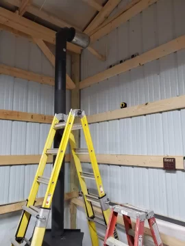

Current plan is to run stove pipe up the wall with a 90 at 10'
Insulated Class A into the wall thimble measuring 3' into a T on the exterior.
Class A out of the T up above the required height.

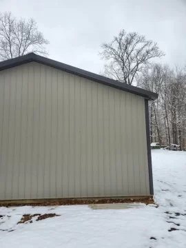

The plan is to exit through the upper right corner of the building as shown on the exterior.

Why not go straight up, that elbow at that height will eventually be the source of issues down the road. Creosote build up, lack of a clean out and to much turbulence from the 2 90deg turns might create smokey reloads & sluggish draft
To be honest, lack of knowledge and trying to avoid holes in the roof.
It just seemed like a good idea to avoid holes in the roof.
