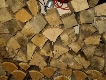

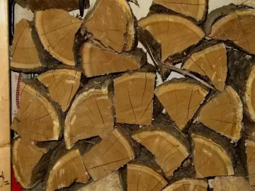

Here are some images of our wood supply brought to our house from the woodshed supplying the cabin, my Dad, and us. Each tree or woodpile is divided to whoever needs it. The better wood with bark on it will be sold,my Dad will not sell wood that should have bark on but doesn't. We do NOT cut live trees for firewood only dead or fallen trees so after seasoning and during splitting the bark often comes off or is loose. We also do not sell wood that is pulpy on outside such as the cherry we take that stuff. All trees bucked to fireplace length logs (16"). For past 3 years now since we bought a splitter that sometimes works we have been splitting the logs prior to stacking the logs to season. It is easier than lifting a large log 2x. So the logs are seasoned as splits except those that are too small to split. Instructions state in manual for T5 - unsplit logs are preferred for extended overnight burns
According to Woodheat and DIY
A piece of dry firewood has cracks or checks in the end grain. Look for these when judging the quality of firewood.
But it's still a good idea to check over the wood: make sure you see cracks in the center of the logs, which is a telltale sign that the wood has lost a lot of moisture. The bark also gets loose as the firewood dries.
I can often start a fire with smaller cherry logs set on twigs and paper in my fireplace to a full burn in a few minutes with minimal smoke on a cold start with no embers.
At the cabin twigs and paper just smolder and smoke for several minutes on hot embers until I crack the door and throw in a match. The smoke goes up the chimney but rises more quickly and empties the firebox when I crack the door.
As you can see from the photos our wood is cracky:
