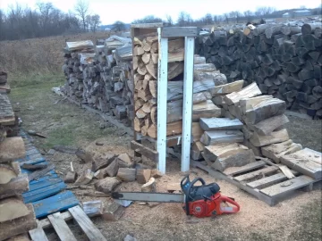

. And that won't be too bad. The lack of smoke is the first thing I noticed. While those around me are spewing smoke from their chimneys I've a very nice burn going and nothing coming out the chimney.
![[Hearth.com] New Buck 80 Burn Report and Operational Questions [Hearth.com] New Buck 80 Burn Report and Operational Questions](https://www.hearth.com/talk/data/attachments/90/90424-3023b150c38d78e1487158e5809c2d4a.jpg?hash=7Su3uMWLuA)
, I brought up some larger splits and will try them to see what goes on. Thanks!
