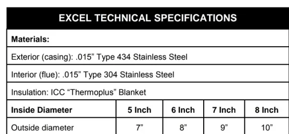

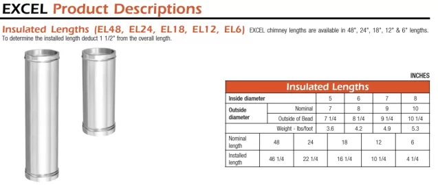

I am going to be ordering a new stainless chimney crown from Rockford Chimney Supply. I don't have a piece of chimney pipe available to measure, what size hole do I specify for them build into it? I have 6" Excel SS insulated pipe. Thanks.
[Hearth.com] New chimney crown
If that's the same stuff you have, maybe 8.125" if it is smooth and uniform in shape on the outside.

The OD is 8" but there is a little bead below the top edge which makes the OD at that point 8 1/4".

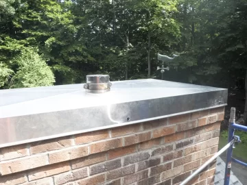

I got a stainless crown cover from Rockford and could not be happier. I used a storm collar mounted above the pipe clamp.

My alternative was to bust out the leaking 6" thick rebar reinforced concrete crown and repour it on top of a 6' x 3' chimney. The stainless with the drip edge is bullet proof and MUCH easier.
True much easier, plus my chimney chase is OSB and vinyl siding, probably would probably never support the weight of concrete. To ad to that my roof is 21 years old and will need replacing in the next couple of years $$$$, once it's on, my plan is to rarely if ever walk on it again. That crown on your chimney looks great BTW.
Thanks Sodbuster. It was actually alot of fun to install once I convinced myself not to smash out the old concrete crown.
We had terrible water problems and it was not obvious exactly where the old crown was leaking but the stainless steel cover cured it. Rockford was a pleasure to deal with.

The turn around time was pretty quick - I want to say around 7-10 days from order to delivery. Definitely measure twice or three times to be sure your numbers are correct. I made mine 1/2" oversize all the way around just in case but mine was hard to measure since the crown sloped at so many weird angles. Must have been a drunk mason poured my crown!

Yes, that would be an expensive mistake. Looks like you used Tapcons, did you draw them in tight or just snug them up?
I did use tapcons. Some of them stripped out when I tightened too much and I had to drill deeper and use longer tapcons in those spots. I learned fast and made sure to "snug" rather than over tighten.
I don't think you gain much by over tightening - it just has to hold the cover from lifting up.

That's what I was thinking too, just snug them up 6-8 stainless screws (wooden chase) into wood, and that babies going nowhere.

Sorry for the bother but when you say 1/2" all the way around, you are saying 1/2" total. In other word, if your chimney measured 30" x 40", you ordered 30-1/2" x 40-1/2". Correct? Mine should be fairly true, all depends on the carpenter.
No bother at all. If my chimney measured 30"X40" I would have ordered 31"X41" to get 1/2 inch overhang on all sides. I had a crazy non-uniform chimney that was practically impossible to measure easily and I wanted lots of room for error.
It worked out great - I measured like 10 times and it came perfect.In your case it sounds like less chance for error.
