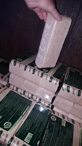

I am burning bricks (envi8) this year. I have burned them in past years some but this year my firewood guy retired so I have been burning them only. I went through 3 tons this year. I haven't checked it but it's supposed to be near zero. Every time I cleaned the chimney this year it was almost a waist of time since there was no build up at all.Have you checked the moisture in this wood? Thought you were burning bricks?

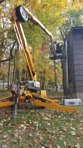

I only get a short amount of sun light in the morning on that side of the house plus the siding was put up the third week of November and the neighbors house is not close enough to have any effect on my house. Also the only place the siding is warped is directly behind the discolored section of chimney pipe.It might not be heat from the flue doing this. I had a similar issue and it was the sunlight reflecting off my neighbors Windows. Google it...very common and overlooked problem with vinyl siding. You could be getting a double dose of heat from the chimney reflection given that it's a reflective surface.
That is the end of October. 3 weeks before the siding went on.I am probably going to suck it up and use the electric heat for the rest of the year. I used a lift to put it up and the ground is probably too soft to get the equipment back there and I'm not going to try to do it with laddersView attachment 176106

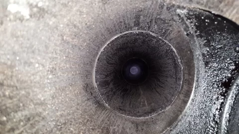

The hollow sound has me stumped as well I sent the pictures to Selkirk and they are trying to figure it out. Usually when you have a chimney fire it burns its way up not just one section. Also there is no sign of anything wrong when you look up the chimney. Also if you look at my stove picture you will notice the inside black stove pipe is not discolored at all. If there was a fire in there I think it would turn the black to grey but it still looks newWell, at the risk of stating the obvious, something got those lower sections too hot. It seems very unlikely a chimney fire in the new chimney sections from what you've said, but something got the lower sections very hot and reaching 160 F two inches away from the chimney to warp the siding doesn't seem too hard to do.
