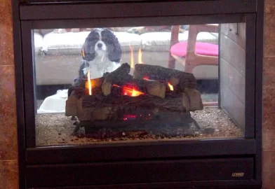

If you can handle the glass, I would still suggest a DV unit. We have a Lennox double sided and really like it.
The problem with open units is that they suck all that other heat - which you already paid for - up the chimney. They can also cause other problems in a newer (tight) house.
I have attached a pic of mine.
Another advantage is less gas use. Still another is that it can serve as a backup heat source when electric goes out - your furnace will not work in those conditions.

Cute Dog Craig......
I reckon that the ASPCA would not approve of your dog being in the fire. Shame on you!
LOL
