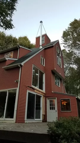

This would be our version of a steep pitched roof, and the pipe exit on the low side. We're happy with the form and function inside and out. There is not a chase around the pipe. After removing part of the inside piping, we would clean from the inside.
Depending on the stove you may not have to remove the pipe at all. Rotary cleaners go through 45s easily

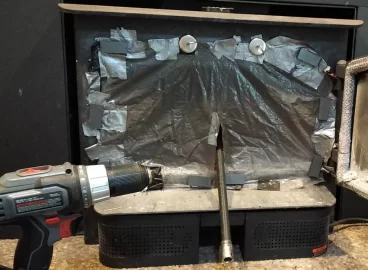

This may be a good solution for us. How do you clean from the inside without making a huge mess? And since you’re here, how do you like your Oslo?
Bholler-Thanks, I’ll look into cleaning from inside the stove.

The 45s and inside 2 sections of straight pipe get unhooked at the stove and ceiling box and taken outside to be brushed. We have an 8ft ceiling so it's only two 3ft sections of straight. The one off the stove is telescoping so slides up for access. I've found using packaging tape and some kind of bag with a slit in it is cheap and easy, and works to keep the dust contained. Tape the bag (we have animals so use feed bags, or an old pillow case etc) to the ceiling thimble. Run the brush rod up through the slit. Dust gets drafted up the pipe, soot falls in the bag, almost nothing escapes out of the bag. This all seems to work well as long as there is easy access and straight piping. Any other setup may require flexible rods and going through the stove, but I have the rigid rods already, and as long as it's disassembled, I do like to be able to shine a light up the pipe to get a good look at it. As far as the Oslo, I would say on a scale of 0-10, I would give it a 9 or 10. We don't use the front door except for cleaning (it drops ash when opened). The ash pan is handy if cleaned regularly. The front damper can get hot, but just tap it vs hold onto it. It looks good year around, and we weren't afraid to have it situated as a focal point in the house. Some say 1cuft per 1000sqft of floor space is a very rough guide to sizing a stove. It's 2cuft, and we have 2000sqft. It heats well when it's 50f, or -40f outside, so we seem to be covered. We use it 24/7 from October to April, and if we had to do it all over again, I would say it would still be a go.
I would put it a couple feet from the center of the ridge. All that outside pipe will diminish your performance, look unsightly and impede maintenance. Make the design firm think a little bit more and work for their money.
I've seen no evidence of diminished performance. No one who has looked over the situation here has said "what an unsightly POS". A 12/12 pitch is a maintenance issue anyway - no one is going to be getting up on the roof unless prepared to do so and only if there is no other way. Also there is a substantial dormer within several feet of the outside pipe. If that weren't the case then it all might be a different situation.

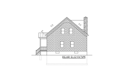

Our plans are slightly modified from this stock plan. Here the stove is similarly positioned on the low side of the roof line. The stairwell will be open to the finished basement. From a living space perspective, we like it here, but if this setup will cause burn performance issues we may move it. Our local dealer/installer didn’t think it was any problem, but I wanted to gather additional experienced insights.

It looks like the drawing shows a chase being built around the class-A. If that's the case then the issue with bracing isn't an issue at all. Make sure they put a proper cricket behind it (it looks like there is one in the drawing), stainless chase cover and have them put in an access door below the T so that you can get in to remove the T-cap to clean it out.

I’ll have to do some research and identify what a “cricket” is. In the drawings, there doesn’t appear to be a T or spot for a clean out in the pipe.
Thanks again.
Thanks HomeinPA. I learned something new today. There does seem to be a cricket on the drawings. I’m starting to like the idea of cleaning from the bottom if we do end up with the stove on this wall.
